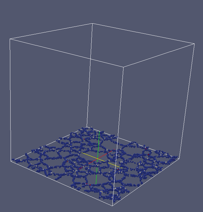

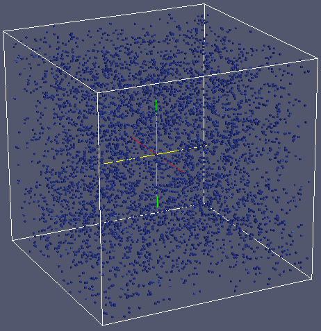

Check the attached images produces on OsX and Windows using data in Archive.zip (check with Utkarsh for the dataset).

png Windows_401.png (52,907) 2013-09-16 13:07
https://www.vtk.org/Bug/file/9524/Windows_401.png
png
png OSX_401.png (74,905) 2013-09-16 13:08
https://www.vtk.org/Bug/file/9525/OSX_401.png
png

(0033177)
Utkarsh Ayachit
2014-08-02 17:51
commit 340d1bae94100b8f459680ca8d0c15fbab0e8e1d
Author: Utkarsh Ayachit <utkarsh.ayachit@kitware.com>
Date: Sat Aug 2 17:48:37 2014 -0400
    BUG 0014279. Fix random glyphs on Windows.
    BUG 0014279 was encountered because the code that used rand() didn't not
    take into consideration that the int value returned by rand() may be
    less than the number of point ids in the dataset. On Windows, is was
    indeed limited to 32767 (on unixes, it wasn't that low). Thus resulted
    in the rand point ids selected being limited to that range.
    Fixed that.
    Change-Id: Ifd0e13cdba8404776a2388e2c5c3f68c6889a8ca
(0033178)
Utkarsh Ayachit
2014-08-02 17:54
Alan, you can test this out without the actual data by simply creating a large dataset with more than 32767 points e.g. Wavelet with extents 0, 64, 0, 64, 0, 64.
