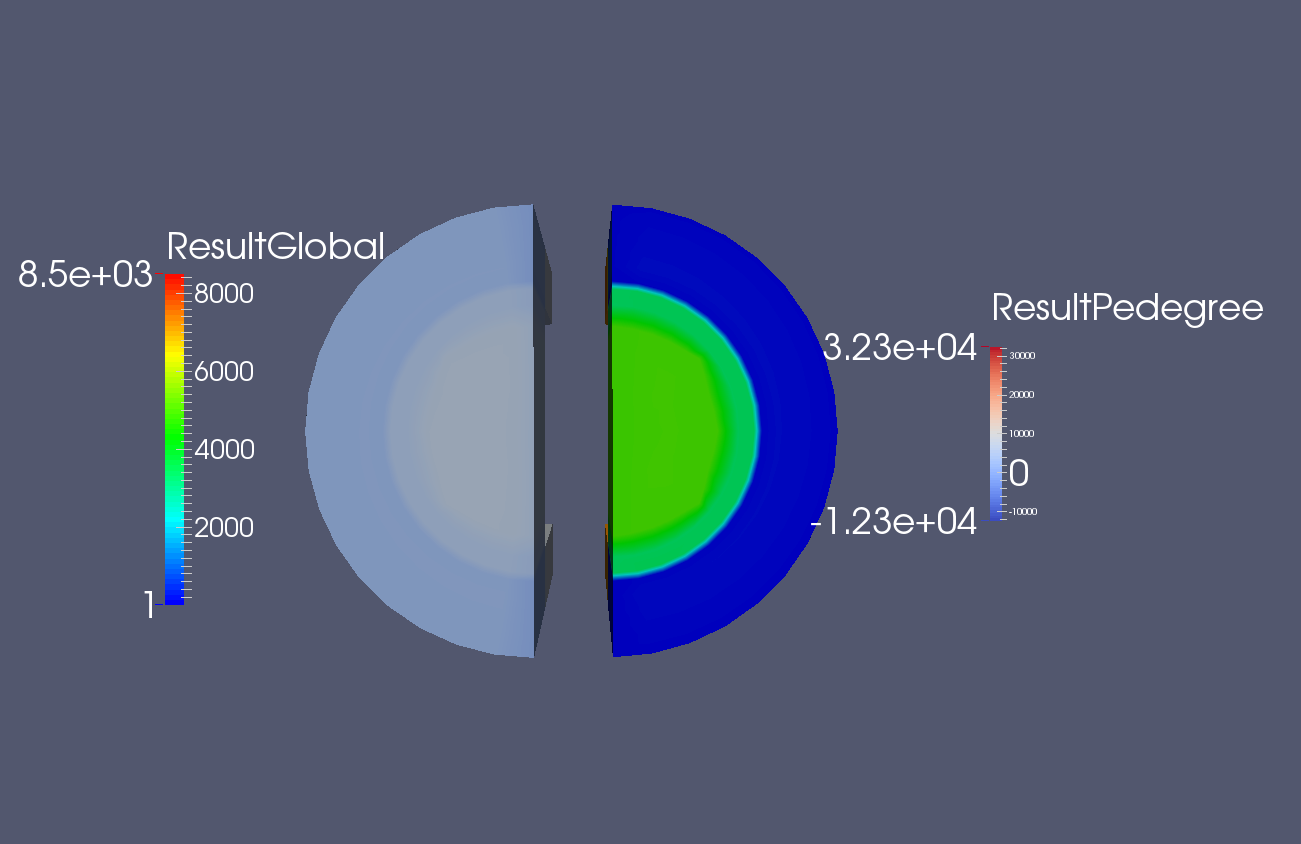

| Description | The color legend is too horizontally wide, with the min and max value on the left side of the color bar and the tick marks on the right.
Please add a user selectable option on the Edit Color Legend Properties to draw the min and max on the right side, under the title. Make this selection be sticky between sessions.

To test:
- Create cylinder source
- Change coloring to TCoords. The color legend should appear with the title on top and tick marks on top.
- Click the Edit Color Map button
- In the Color Map Editor, click the "Edit color legend properties" button
- Check the "Add Range Annotations" checkbox.
- Change the "Tick and Annotation Positions" from "Ticks right/top, annotations left/bottom" to "Ticks left/bottom, annotations right/top"
- Click OK
- The color legend title should be on bottom and the range annotations should be on the top. |

Waiting for feedback from Cory. I believe we actually want the option for all annotation (minor and min/max) on the right side. |
