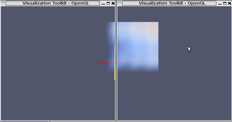

| Summary | 0010594: GPU image volume rendering does not work correctly on tile displays | ||||||||
| Description | Run pvserver as follows: mpirun -np 2 pvserver -tdx=2 Now connect with the paraview client and and do volume rendering for wavelet using GPU based volume renderer. You'll see something like the attached image. That's totally wrong. | ||||||||

(0021152) Utkarsh Ayachit (administrator) 2010-06-23 17:03 edited on: 2010-06-23 17:03 |
VTK COMMIT commit b7a26891357d93a4bf1dcb21b35ae63ebc6dcb9d Author: Utkarsh Ayachit <utkarsh.ayachit@kitware.com> Date: Wed Jun 23 17:00:27 2010 -0400 Fixed BUG 0010594. Fixes issues with tile displays. vtkOpenGLGPUVolumeRayCastMapper was changing the projection matrix. However, doesn't seem like there's any need for it (couldn't determine why that was d at all). I am removing this so that it avoids changing of the projection mat which was messing with IceT when rendering in tile-display mode. |
