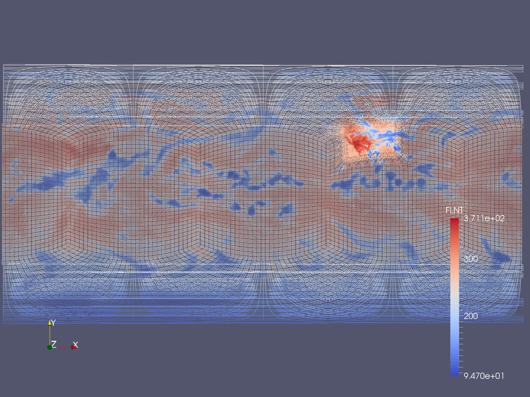

| Description | We are getting artifacts (bad cells) with the Unstructured CAM reader. * Local server, Master, Linux. * Open file f1850_arm30x8_rel06.cam.h3.0002-06-25-00000-Do-Not-Release.nc. Default reader. Connectivity File Name: arm_30_x8_lowconn.g_latlon-Do-Not-Release.nc. Single Level On, Cell Layer Right, Off. Apply. * Wireframe. Paint by TMQ or FLNT. <<bug>> Notice that there are some cells that go all the way across the mesh. Something is wrong with the reader at the left and right edges. Including a screenshot. The horizontal lines are the problem. Utkarsh - ask me for this dataset. Note to self - MT, g drive, on Linux. | ||||||||

(0034706) Utkarsh Ayachit (administrator) 2015-07-08 15:01 |
Dave, I have the dataset. |
(0034764) Utkarsh Ayachit (administrator) 2015-07-12 20:39 |
Merge requests: VTK: https://gitlab.kitware.com/vtk/vtk/merge_requests/410 [^] ParaView: https://gitlab.kitware.com/paraview/paraview/merge_requests/213 [^] |
(0034770) Utkarsh Ayachit (administrator) 2015-07-14 04:55 |
Fix merged. |
(0034796) Alan Scott (manager) 2015-07-16 21:30 |
Beautiful. Just sent a screenshot to my customer. Tested Linux, local server, master. |
